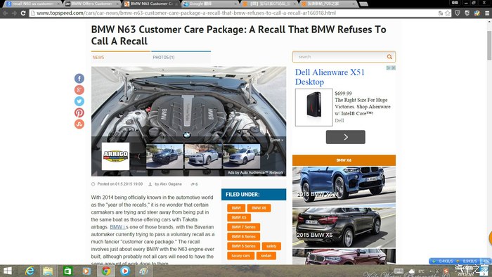

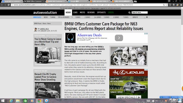

今天早上我上网搜索了一下关于BMW N63的召回新闻,发现这是不久前才公布的召回计划。找了一个新闻截了图,标题是BMW N63 Customer Care Package: A recall That BMW Refuses To Call A Recall.翻译过来就是《宝马N63引擎客户关怀包:一个宝马拒绝称之为召回的召回》

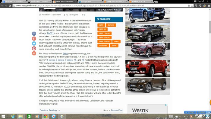

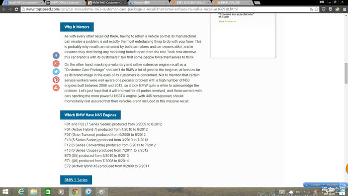

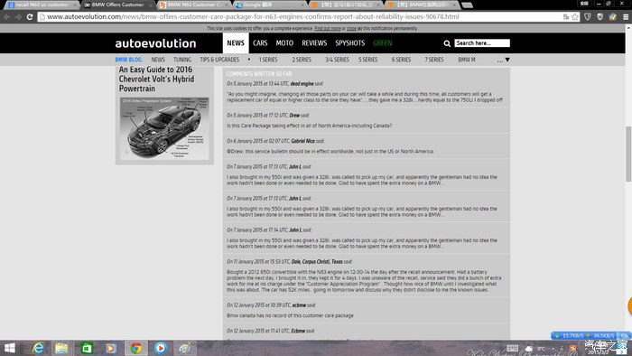

这张图就是我截图的新闻网站,除了可以看见标题外,大家还可以看看新闻内容
这两张图的新闻内容我会复制过来并翻译一些主要内容供大家阅读
这是叙述的为何会召回以及安装了N63发动机的涉及召回的车型,不知道中国是否也会召回。。。但是据我所知中国N63引擎保有量太少,基本见不到550GT 550i 750i或者X5 50i X6 50i等等涉及召回的车型,主要此类车型的排量大,进口关税高,导致国内价格虚高。基本装配了N63引擎的宝马的指导价格都在150万以上,基本这个价位大家也不会买这种车型,倒是这种车型在北美的保有量比较大。大家都喜欢大排量大马力的豪华车,对于5系GT来说,顶配引擎就只能选到N63,而550i相较于M5 750i相较于760i还是便宜不少的,所以有不少人选择购买50i的车型。

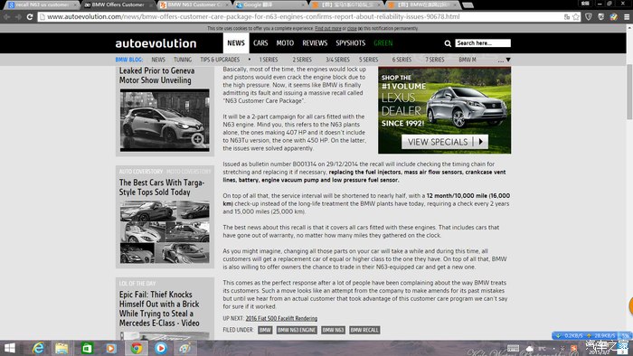

下面是英文原文,我选用了另一篇报道,比截图的这一篇更详细一点,想知道所有内容只要贴进谷歌翻译就能了解的差不多了(简单翻译重点):
Not too long ago, we were telling you that BMW’s N63 4.4-liter V8 engines are experiencing reliability issues and that in a lot of cases, the owners are downright disappointed in the way their plants perform.
不久前,N63 4.4升V8发动机遇到可靠性问题,顾客对此很失望。
The info came to us initially from a mechanic that had to deal with a lot of malfunctioning units. According to him, the plants weren’t even up to the 20,000-mile mark when they came to his attention, showing issues related to the injectors and mass air flow sensors that led to more serious issues.
来自一个机械师的信息表明,处理这个问题需要处理大量故障代码。喷油嘴和空气流量质量传感器显示出一些问题,这些问题可能会导致更为严重的故障。
Basically, most of the time, the engines would lock up and pistons would even crack the engine block due to the high pressure. Now, it seems like BMW is finally admitting its fault and issuing a massive recall called “N63 Customer Care Package”.
大多数时候,引擎基本上会因为高压力而锁止,活塞甚至会因为高压力而使发动机缸体裂开。现在,宝马似乎终于承认了错误并提出了大规模客户召回并称之为“N63客户关怀包”。
It will be a 2-part campaign for all cars fitted with the N63 engine. Mind you, this refers to the N63 plants alone, the ones making 407 HP and it doesn’t include to N63Tu version, the one with 450 HP. On the latter, the issues were solved apparently.
此次N63引擎是407匹的版本,不包括N63Tu 450匹马力版,因为N63Tu已经解决这个问题。(注:50i基本在13年后就配备了N63Tu发动机,而之前的车型配备的都是407匹马力的N63,我的550GT就是407匹的版本)
Issued as bulletin number B001314 on 29/12/2014 the recall will include checking the timing chain for stretching and replacing it if necessary, replacing the fuel injectors, mass air flow sensors, crankcase vent lines, battery, engine vacuum pump and low pressure fuel sensor.
12月29日发布了公告编号为B001314的召回,此项召回包括检查正时链条的延伸和更换,在必要情况下更换喷油嘴、空气质量流量传感器、曲轴箱排放管、电池、发动机真空泵、低压燃料传感器。
On top of all that, the service interval will be shortened to nearly half, with a 12 month/10,000 mile (16,000 km) check-up instead of the long-life treatment the BMW plants have today, requiring a check every 2 years and 15,000 miles (25,000 km).
同时,基于之前藐视的检测,车辆保养周期也要缩短至原来的一半,从现在宝马执行的长保养周期2年1.5万迈(约合2.5万公里)变为1年1万迈(约合1.6万公里)。
The best news about this recall is that it covers all cars fitted with these engines. That includes cars that have gone out of warranty, no matter how many miles they gathered on the clock.
在关本次召回中最好的消息是,此次召回涵盖了所有装有N63发动机的汽车,这包括已超出保修期的汽车,无论他们开了多少英里。
As you might imagine, changing all those parts on your car will take a while and during this time, all customers will get a replacement car of equal or higher class to the one they have. On top of all that, BMW is also willing to offer owners the chance to trade in their N63-equipped car and get a new one.
宝马会在召回期间提供一辆代替使用的汽车,这辆替代汽车会等于甚至高于他们所原有的(被召回的)汽车的等级。同时,宝马也会提供车主一个机会去置换他们原有装配N63引擎的车型去购买新的车。
This comes as the perfect response after a lot of people have been complaining about the way BMW treats its customers. Such a move looks like an attempt from the company to make amends for its past mistakes but until we hear from an actual customer that took advantage of this customer care program we can’t say for sure if it worked.

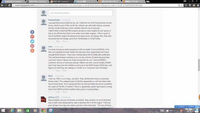

这段报道的原文截图如下
最后一段是总结,与召回无关,我就不翻译了。综上所述,宝马在2014年12月29日宣布召回了装配N63发动机的所有车型。虽然中国的N63保有量不多,但是希望宝马可以全球统一召回,不能忽略那些在中国花费近两百万购置了N63发动机车型的车主,不然这显然是不公平的。

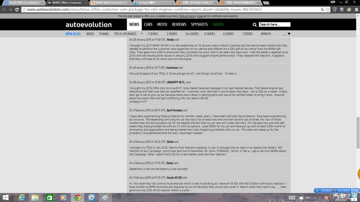

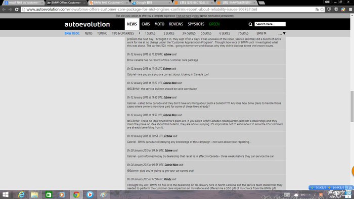

附上一些网友的回帖
可见大家对此次召回的关注度还是很高的。

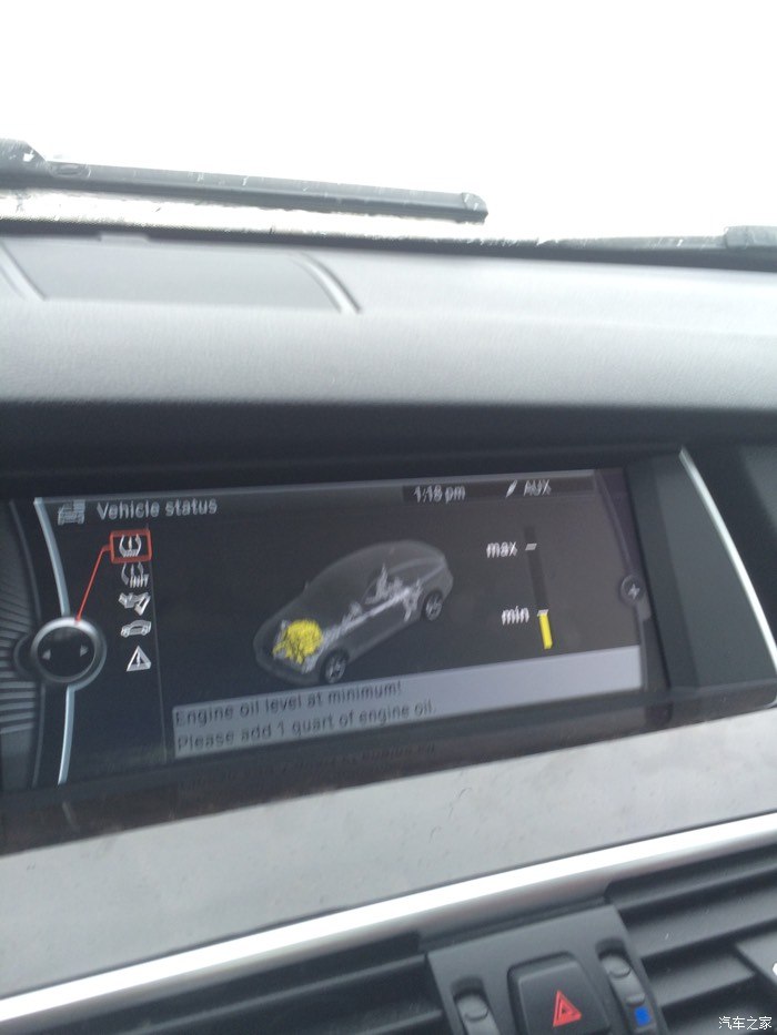

之前逛论坛的时候也发现很多550新车安装了N63发动机的,一开始就有烧机油的问题,我现在也是基本上一周去添加一次机油,还好我们4S店机油是免费的。。。
提示更换机油

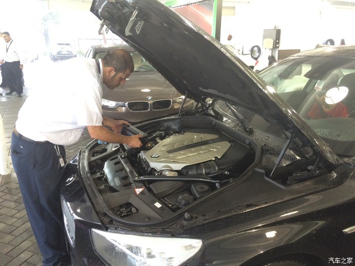

又是这个小哥给我换的机油
最后附上大黑的几张照片,希望他早日归来。
