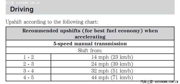

2012款经典福克斯换挡速度和离合注意事项
2012款经典福克斯换挡速度,是截图英文版的说明书上的
【大致对照表, 大家在实际行驶过程中,观察对应的转速】

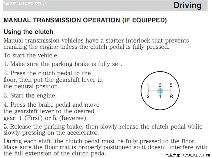

Reverse
1. Make sure that your vehicle is at a complete stop before you shift into
R (Reverse). Failure to do so may damage the transmission.
2. Move the gearshift lever into the neutral position and wait at least
three seconds before shifting into R (Reverse). 【换倒档,要车子停稳,等待3s钟,这个中文说明书里面有提及】
? The gearshift lever can only be moved into R (Reverse) by moving it
from left of 3 (Third) and 4 (Fourth) before shifting into R (Reverse).
This is a lockout feature that protects the transmission from
accidentally being shifted into R (Reverse) from 5 (Fifth).

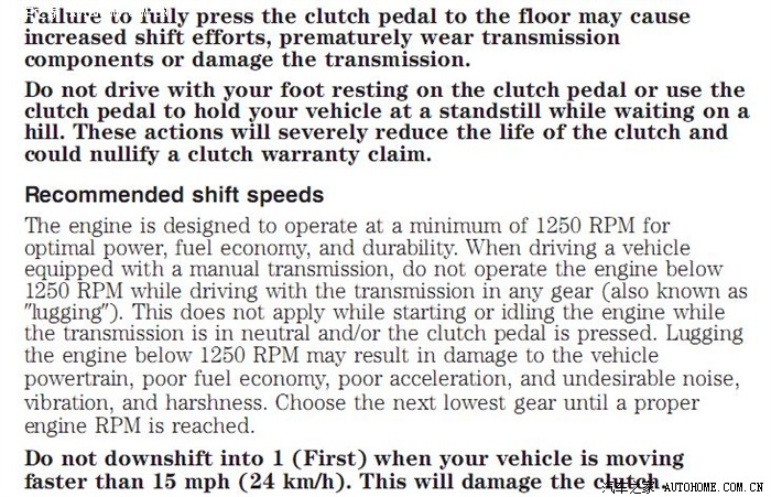

【在速度高于24公里每小时, 不要换到一档;会损害离合器】
