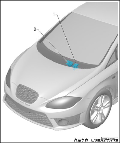

根据网上找到的参考资料:
http://seat.workshop-manuals.com/leon-mk2/index.php?id=27298
http://seat.workshop-manuals.com/leon-mk2/index.php?id=21204
发动机型号为 BWJ, CDLA, CDLD的有Structure-borne sound of the engine (Soundaktor)
Engine Codes
2007-2009 Cupra - BWJ
2010 Cupra - CDLD
2010 Cupra R - CDLA
国内卖的CUPRA是CCZB
就是中间这个控制单元,应该能拆掉。低速时的嗡嗡声就能消除了
